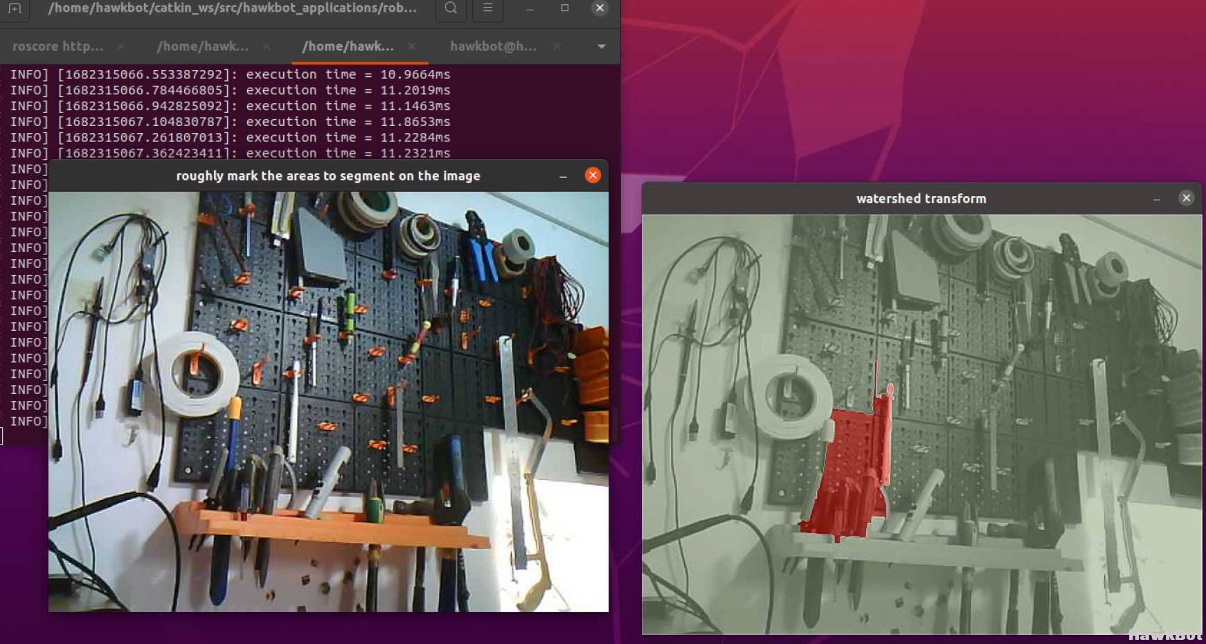

水域分割又称Watershed变换,是模仿地图浸没过程的一种形态学分割算法,其本质是利用图像的区域特性来分割图像,它将边缘检测与区域生长的优点结合起来,能够得到单像素宽、连通、封闭确位置准确的轮廓,因此是应用比较广泛的一种图像分割方法。
hawkbot@hawkbot-ubuntu:~/catkin_ws$ roslaunch robot_vision watershed_segmentation.launch
... logging to /home/hawkbot/.ros/log/b1a8f776-e260-11ed-8599-218ddfb2e606/roslaunch-hawkbot-ubuntu-3407.log
started roslaunch server http://192.168.100.238:39509/
* /watershed_segmentation/debug_view: True
* /watershed_segmentation/queue_size: 3
* /watershed_segmentation/use_camera_info: False
    watershed_segmentation (opencv_apps/watershed_segmentation)
process[watershed_segmentation-1]: started with pid [3421]
[ INFO] [1682315030.499788566]: Initializing nodelet with 1 worker threads.
[ INFO] [1682315030.618005490]: This program demonstrates the famous watershed segmentation algorithm in OpenCV: watershed()
[ INFO] [1682315030.618055787]: Hot keys:
[ INFO] [1682315030.618074269]:         ESC - quit the program
[ INFO] [1682315030.618082885]:         r - restore the original image
[ INFO] [1682315030.618093175]:         w or SPACE - run watershed segmentation algorithm
[ INFO] [1682315030.618120400]:                 (before running it, *roughly* mark the areas to segment on the image)
[ INFO] [1682315030.618160933]:           (before that, roughly outline several markers on the image)
